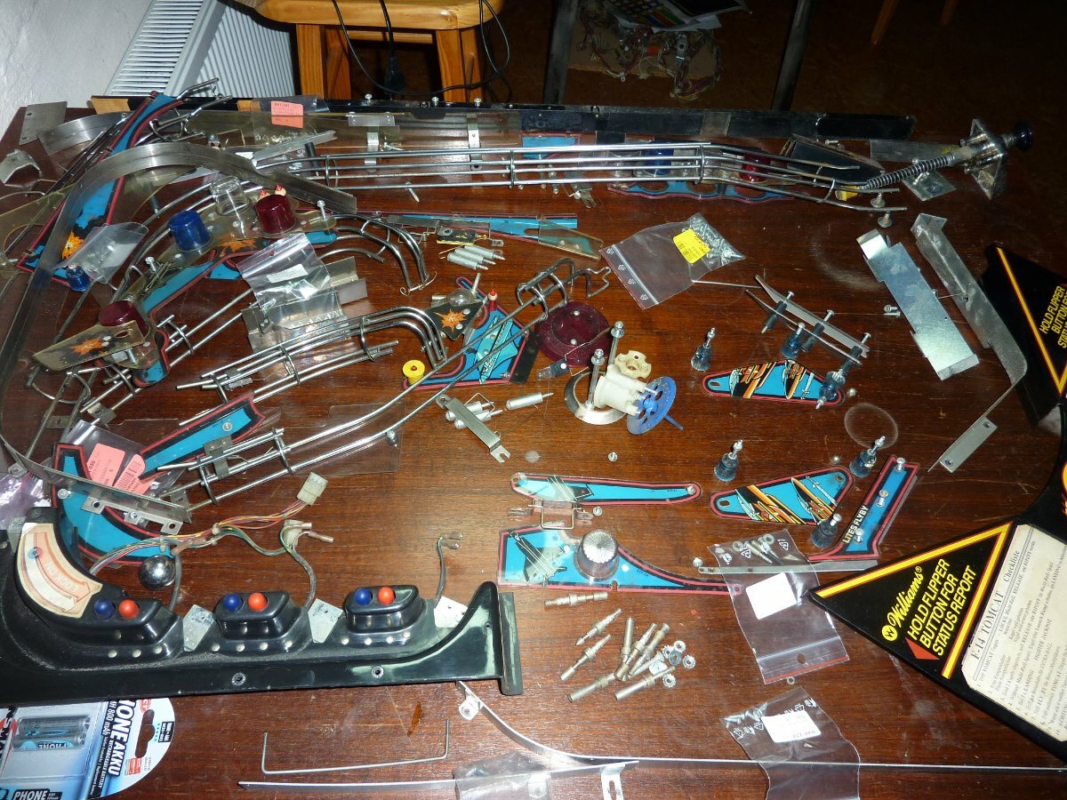

BTW: I spent some time with my F-14 yesterday, to. Alas, I was not having fun, but only ripping everything apart, but now I can start working on the playfield.

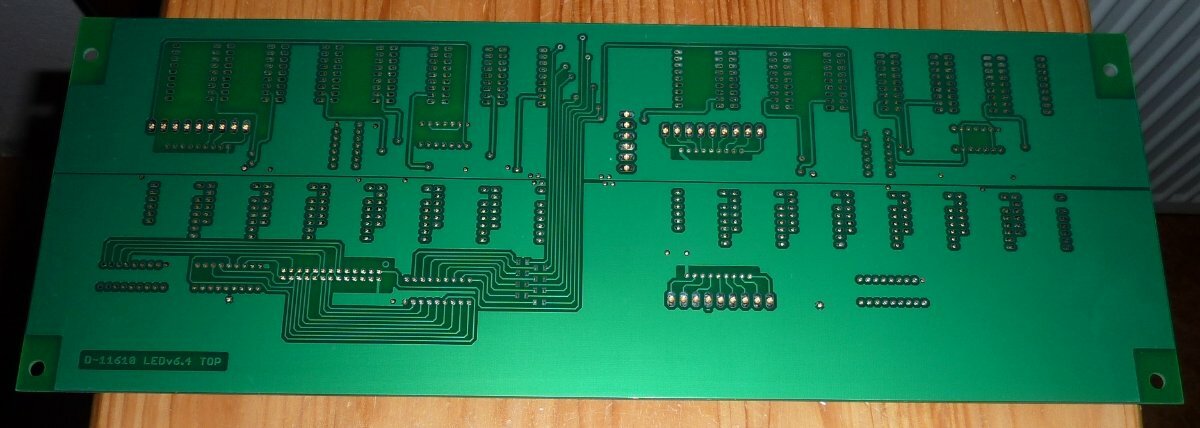

However, I might also have something for you. A friend of mine and myself did some LED display boards 20 years ago and I still have some unpopulated boards left.
At the time only bright red LEDs were available on the free market, so we had to use those for our design. For a few games this just doesn't fit, but F-14 is one of the games where these really fit a lot better than the old ones.
The old picture on the web page is a bit outdated as the actual version doesn't use these big through hole transistors any more, but the IRF7316 ICs I also used on the APC board. The component list seems to be up to date though.
Think about it, of course I'd also just charge the shipping.

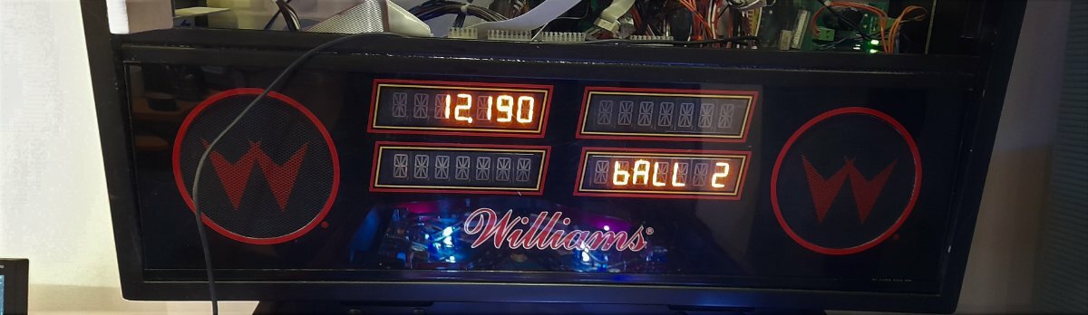

So my F14 already has an LED display board in, but just a normal orange one.  Putting in a board with bright red ones might be interesting, so I'd like one of your blank PCBs if possible.  We can exchange addresses via PM, I'll pay to send the ramp and you can pay to send the PCB, keeps it simple I guess.
It's yours, but you might still change your mind because:
One measure to get my F-14 into use was to get it's display cables out of my Black Knight where they were used to control my alphanumeric Sys7 display. I therefore did a respin of the driver board to also feature the egde connectors that are used by System 7 displays.
That means I don't need the previously used board any more (it's the lower board in the picture at the 4 Alpha + Credit page) and I could also send this to you instead of the normal F-14 one. The advantage for you would be to have alphanumeric displays in the upper and the lower row, as well as to have a credit which you might or might not want to use. And the board is already populated and tested.
The drawback would be that I can add a board for the credit displays, but I don't have any spares of the alphanumeric ones which means you'd have to order them by yourself. Of course these board won't fit into the original display mounting, but this shouldn't be a big deal.
As before I'd just charge the shipping for the driver board and the credit.
Independent of which board you choose there's one thing you should know also. The LED displays we used are a bit too wide to fit and need to be grinded a bit (roughly 1mm). I use a bench grinder for that, but a belt grinder works also.
Bearbeitet von Black Knight

Putting the ball number on the display was easy.  I still need to sort this out if there is a 4 player game (it then alternates between the score and the ball number for the current player).  But this is fine for now.20220228_170831.jpg.6d81f32f40e8ee5d6e144ca640b0eba7.jpg

BTW, I'm trying to find out what the price is for shipping the display board to the UK and then send you a PM.

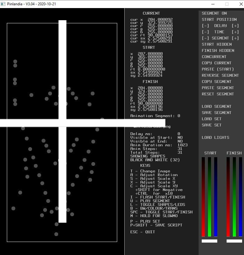

The source for the MPF show creator is on Github.  It's written in something called BlitzMax which I never heard of, but I managed to download it and get the creator compiled.  The code that actually outputs the MPF show file is a very small part of the program, maybe 20-30 lines.  It should be really simple to change it to output code that can be pasted into APC as a function.  I'll play with that later and see how it goes..
vor 3 Stunden schrieb Snux:
I know this wouldn't be as efficient as the lamppattern logic in APC at the moment
That's true, but the LampPattern logic is only working for all playfield lamps and I think it might be a good idea to have an additional system to handle not all but only certain lamps (like the Pinbot chest). This could then work with on/off lists like MPF is doing it. For normal lamps such a list entry could look like:
(byte Time to next step), (bool TurnOn or TurnOff), (zero terminated list of bytes with the numbers of the affected lamps)
I'm currently implementing something similar for LEDs. I have to explain it better in the DOCs, but the idea of this mode 2 is that you just change certain LEDs to the specified color and leave the rest untouched.
In this case the usual data pattern with each bit representing an LED is sent. Normally a 1 means the lamp is turned on to the selected color (mode 0) or it keeps it's color (Mode 1), but a zero means it is turned off. This is not true in Mode 2 where a 1 means the LEDs are getting the new color immediately (no fading), but a zero means the LED doesn't change it's state. So in this mode just the delta is send to the LED_Exp board.
It might make sense to implement another mode for switching off the selected LEDs and leaving the rest untouched.
Adjusting the MPF lamp show creator went much better and quicker than I was expecting.  Fortunately I still have the input file from when I was using MPF before - the show creator takes the "monitor.yaml" file which contains things like the x and y coordinates of each lamp.  So I picked a couple of shows I'd made before and ran them through the modified show creator tool.
As an example, for the first show it created the following which you can just paste into the program and then adjust as you need to.  A short video containing both this "rotating wheel" and a "bounce up and down" is here.
Now I just need to look into the best way to block all other lamp calls while the show is running.  Maybe I make my own versions of TurnOn/TurnOff/Blink etc which check some variable that will be set if a show is running and then only call the APC.ino routines if no show running.
